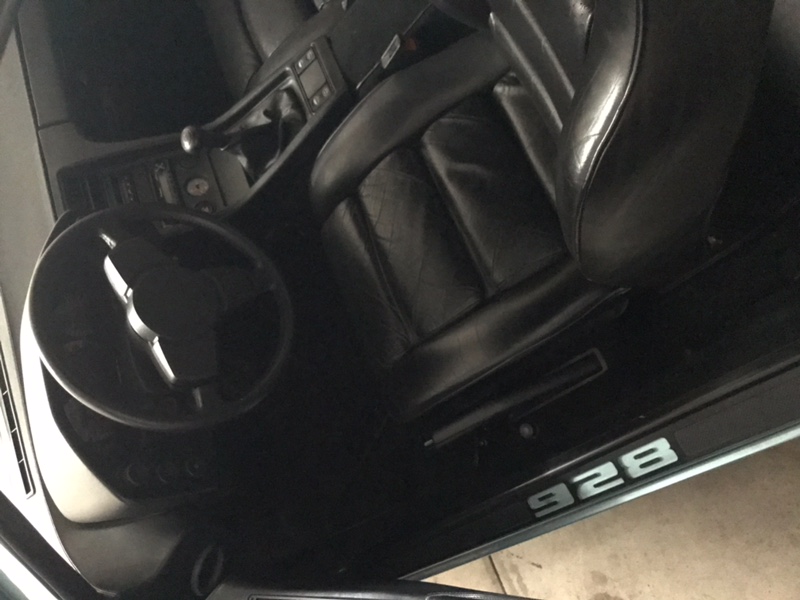

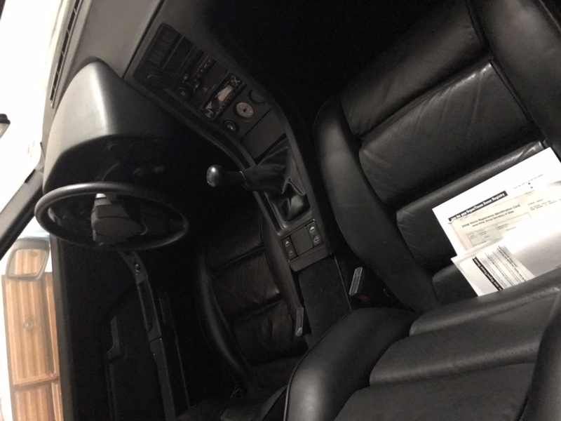

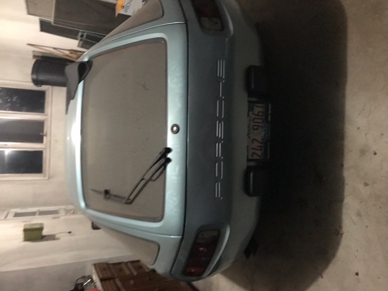

Good morning, KJ here and I am new to the 928 Family and this Club. My history has been in the Toyota Land Cruiser world but in general have always enjoyed cars. I have recently taken ownership of this 1978 928 with 5,400 miles on it. I am looking for some suggestion on getting it started. My plans are to pull the plug as and drop some oil down the cylinders and let it soak, then hand turn the engine over. Next, install new battery (what do you recommend). Last put in fresh gas and then attempted to fire it up.
Much appreciate any suggestions, I do know a major server error was done about 8-9 years ago and that included a new timing chain. the car is due to arrive in San Antonio by Wednesday
I’m not the best at navigating these forums I hope I've uploaded these pics correctly
