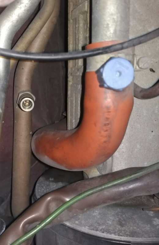

I was wondering if one can tell the difference between R12 and R134A ports? If the R12 system was retrofitted to R134A the Low (L) port would be different from the R134A?
I am attaching what my L port system looks at present. The blue cap was on the port and it is simply laying on top of the hose nearby.

Since the hose is the stock hose, you cannot tell what refrigerant is inside. Later model cars that come with 134A will have 134A only connectors.
If the system was upgraded by a professional it should have an upgrade sticker. If not, you just don't know unless a test is performed.

That is a 134a connector. True you cannot always tell, as I am using 134a in my car with the old style fitting, but I am an HVAC guy, and have 134a in a drum, and use my standard refrigeration gauges.
With that in mind, no one would sensibly install the 134a style ports and try to put R12 back in, so I would assume you have 134a in your system.

Thank you Airtek. I suspected as much and should know for sure on Monday, when my local mechanic check the system.
