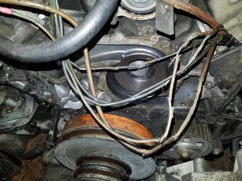

Check the wiring to 14 pin connector under the hood on the passenger side.It has a tendency to deteriorate. I have a 86 that I am rebuilding the engine I found the wiring harness that runs from the 14 pin connector across the front of the engine was burned, before I found this I had the same problem. I replaced all of my instrements with late model counterparts.
