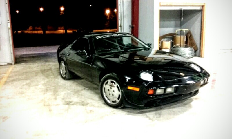

Thanks for letting me join this great forum.i have a 85 928 auto with 160k that i picked up for $2500 that had electrical issues when i bought it from a man that had it 10yrs an couldnt get the dash or ac or windows to work and if youve ever been to louisiana in a black on black car with no air an closed windows then you know it will ruin even a 928s fun.lol
He did remove and clean the gas tank and change the pump and filter and had the maf rebuilt tho.
I took it home and changed all the fuses and cleaned the relays and the grounds above the fuse box an under the dash an the battery strap and replaced the big ground under the car and both ground straps on the fenders by the coils and she fired right up and everything worked even the ac..then i replaced the tb/wp all the plugs and its been my daily driver for a yr now.
So now i have a gas leak under my tank..im hoping the Po left something loose but is there any know prone to leak spots i need to be aware of? Thanks in advance
