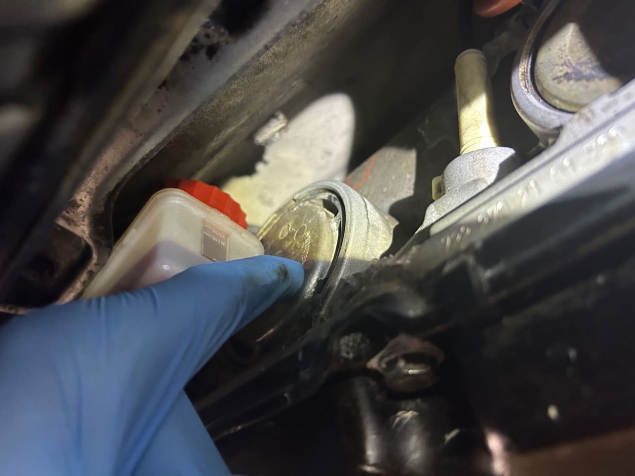

Hi, I am not sure about the drive bearing, however I would like to think that at cold, starting the car, running through the gear selector, waiting up to 5 or 10 seconds before each shift and then checking the fluid level, if it has moved down to the 20 degree mark (see picture showing reservoir), there should be no problem with fluid going into your transmission and torque converter.
I had a lot of issues with transmission leaks. Mine were related to the O ring at the B2 Servo Cover (see picture pointing to B2 Servo Cover), not to difficult to replace, the breather pipe (connection from the top of the reservoir to the transmission body (Porsche Part Number 999 181 167 50), the wrong pan gasket, garage put in part number 126 271 10 80, which was the old type and when I replaced with 126 271 11 80, I had no leaks from the pan. The final leak, was an odd one, it was the reservoir red cap. It turns out the the cap is designed to be torqued down, mine was just finger tight when I got it back from the garage.
