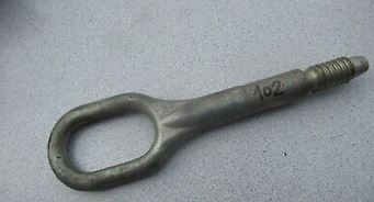

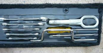

2 years 11 months ago #22457
Look to your tool kit that is at the very rear of the interior hatch area.
This is the tow hook. Look in your owners manual for the points where it screws in. Some lubricant will be needed to aid screwing it in as it will be dry and possible corroded.
