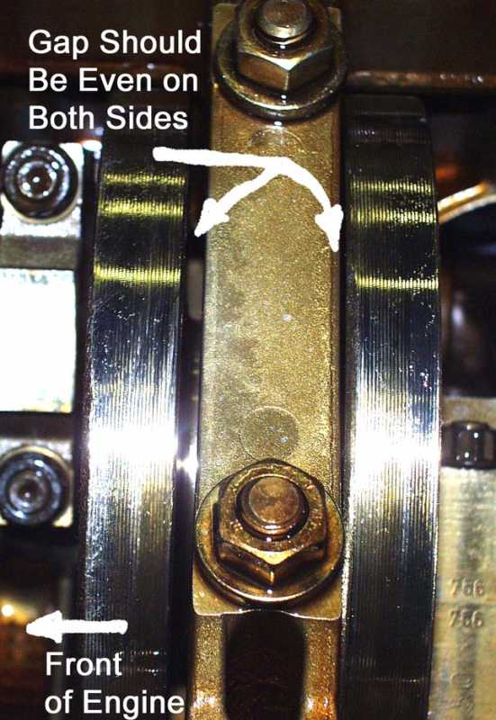

For those who may not be aware of what I think the problem is. Here it is described as due to the flex plate, but I believe it is the thrust bearing failed due to pressure from the flex plate.
I wrote an article about releasing the pressure on the flex plate, see the attachment.
This is a periodic maintenance issue that I recommend on 1985 and newer Porsche 928s equipped with automatic transmissions.
Welcome and sorry to hear of your problem. I am not aware of any company, perhaps other than Porsche, that keeps a new or completely rebuilt Porsche 928 engine in stock ready to ship. The best solution would be to source a good used engine and have a mechanic perform a complete rebuild. Here in the USA companies like 928 International have complete used 928 engines in stock.
