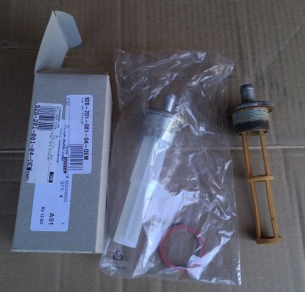

Please be aware that there is an in-tank screen to filter fuel before entry to the fuel pump. Particles can block the pump, some say that briefly applying reverse polarity to the pump electric connectors will reverse the motor rotation and possible clear out obstructions. I've never tried this process.
As the photo illustrates, as the screen ages it may detach from the housing and large foreign particles from the tank can then be sucked into the fuel line. So I suggest replacing this in-tank filter. It is part number 928-201081--04.
If you Porsche 928 has an in-tank pump, that pump also has a screen that can detach. So inspection of the in-tank pump is also recommended. Replacement in-tank pumps are quite expensive, I hope the prices decrease in the future.
