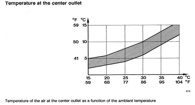

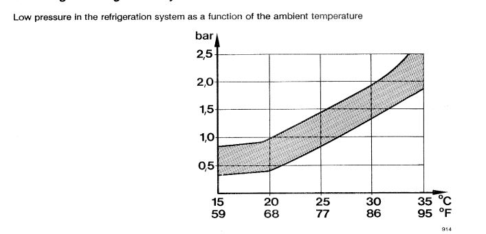

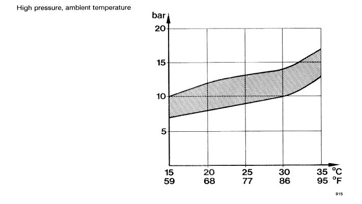

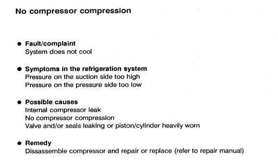

I'd stick with the R-12 until you can replace all of the O-rings and flush the system.
Hi and Low pressures should be equal with the compressor not running.
Low High-side pressure and high suction pressure can indicate a poorly functioning compressor.
Here's info from the Climate Control folder in the CD Set (Roger at 928Rus has them for sale)
1 bar = 14.5 psi

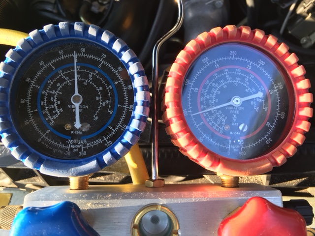

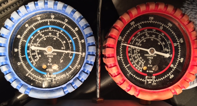

Frank, great detailed information. think i will start diagnosis from scratch using your protocol. i will make no assumptions until verified with data. am prepared to replace hoses, drier, compressor. hope not to need switches, expansion valve, condenser or evaporator.
22 k lb system sounds interesting. thanks a "ton" as they say in HVAC class. very helpful.

I replaced all the O-rings, plus dryer, expansion valves and rear evaporator. I'd say this is a 3-4 in difficulty. Much easier than timing belt, torque tube bearings. Probably on a par with changing the HVAC vacuum system diaphragms. Hardest part was finding the correct O-rings.
Your post-fill pressures indicate a bad compressor. It can't compress enough gas to make liquid, so it pumps gas, with the difference between hi and lo side being the pressure drops in the system. At least that's my take.
The hard part with the 132a changeover is making sure all the old oil is out. The compressor will distribute the oil through the system and you end up with 40% in the compressor, 35% evaporator, 15% condenser, 10% receiver/dryer. You'll have to flush the evaporator and condenser.
